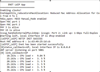

We are developing TCP/UDP IP applications on the AM243x Launchpad utilizing the LwIP networking stack, currently employing SDK version mcu_plus_sdk_am243x_10_00_00_20.
We have encountered connectivity problems while testing the example provided at [Link]. Despite configuring a static IP address of 192.168.1.200 on the Launchpad (operating as the server), ping and iperf tests consistently fail to establish communication. Firewall settings on the PC have been verified.
Could you please confirm the functionality of this example on your system?
Attached the screenshot of Log from the device for your reference:

Following up on my previous reply, I have conducted testing of the DHCP functionality. Results indicate that with SDK version mcu_plus_sdk_am243x_10_00_00_20, the example application fails to set the IP address, despite multiple attempts on both ports.
Screenshots illustrating this are attached below:
(The application shows an invalid IP address after sometime,
The expected IP is 10.xx.xx.xx )
Conversely, testing with the older SDK version (mcu_plus_sdk_am243x_08_06_00_45) yielded the expected DHCP functionality, as shown in the attached screenshot.
This means our setup is working fine.
In summary, DHCP also not functioning correctly with the latest SDK version in my current setup.

I have seen similar issue on my setup with SDK 10.0 and AM243x-lp board.
Which version of AM243x-lp are you using?
Dev team confirm there was some issue with SDK 10.0...
Can you try with latest SDK 10.1 and update the results?
