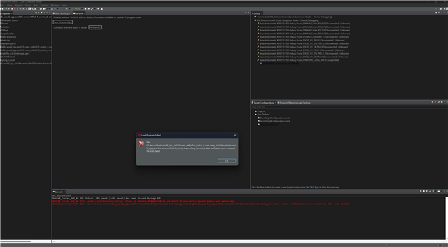

When I try to debug this code on the M4 core, I get these error messages:
BLAZAR_Cortex_M4F_0: GEL Output: CPU reset (soft reset) has been issued through GEL.
BLAZAR_Cortex_M4F_0: File Loader: Verification failed: Values at address 0x00014C40 do not match Please verify target memory and memory map.
BLAZAR_Cortex_M4F_0: GEL: File: C:\dev\ccs\hello_world_cpp_am243x-evm_m4fss0-0_nortos_ti-arm-clang\Debug\hello_world_cpp_am243x-evm_m4fss0-0_nortos_ti-arm-clang.out: a data verification error occurred, file load failed.
Why can I not add/edit code on this project and then debug it? The issue seems to be with Code Composer Studio. How can we address and fix this issue so that I may edit this project and debug off of the M4 core? This same code runs and debugs on the R5 core.

  • Hi Jacob,
    Can you please try once after disabling the verification for M4F core and update the results.
    Please refer sk-am62-data-verification-error-while-loading-the-program for details.
    Tushar

  • I just tried using the No Verification and this did NOT solve the issue
  • Hi Jacob,
    Looking at the above error, it doesn't seems like the verification has disabled successfully.
    I can see you are still getting the data verification failed error which should not come if verification is disabled for M4F core.
    Please make sure you have selected the M4F core while disabling the data verification in Program Load and run options.
    Tushar

  • Hi Jacob,
    I am able to replicate your issue at my end.
    Yes, it seems that the constructor for Foo class is not invoked for the created object. I am still debugging the issue please allow some time.
    Tushar

    Please note that this is on a normal M4 Hello_World_cpp project (no foo code). I tried the 'patch' on a normal example m4 hello world project before I tried adding it to my code.
    The patch does not seem to allow me to build an example M4 project.
    You did not comment the following line:
    section5.output_section[2].$name      = ".ARM.exidx";
    PFA the updated syscfg file:

    section3.output_section[0].output_sections_start = "__BSS_START";
    section3.output_section[0].output_sections_end   = "__BSS_END";
    section4.load_memory                  = "M4F_DRAM";
    section4.group                        = false;
    section4.$name                        = "Code and Read-Only Data";
    section4.output_section.create(2);
    section4.output_section[0].$name      = ".data";
    section4.output_section[0].palignment = true;
    section4.output_section[1].$name      = ".rodata";
    section4.output_section[1].palignment = true;
    section5.load_memory                  = "M4F_IRAM";
    section5.group                        = false;
    section5.$name                        = "Memory and Stack Segments";
    //section5.output_section.create(5);
    section5.output_section.create(2);
    section5.output_section[0].$name      = ".sysmem";
    section5.output_section[0].palignment = true;
    section5.output_section[1].$name      = ".stack";
    section5.output_section[1].palignment = true;
    //section5.output_section[2].$name      = ".ARM.exidx";
    //section5.output_section[2].palignment = true;
    //section5.output_section[3].$name      = ".init_array";
    //section5.output_section[3].palignment = true;
    //section5.output_section[4].$name      = ".fini_array";
    //section5.output_section[4].palignment = true;
    section9.load_memory                  = "M4F_DRAM";
    section9.group                        = false;
    section9.$name                        = "C++ Sections";
    section9.output_section.create(3);
    section9.output_section[0].$name      = ".ARM.exidx";
    section9.output_section[0].palignment = true;
    section9.output_section[1].$name      = ".init_array";
    section9.output_section[1].palignment = true;
    section9.output_section[2].$name      = ".fini_array";
    section9.output_section[2].palignment = true;
    section6.type                        = "NOLOAD";
    section6.load_memory                 = "USER_SHM_MEM";
    section6.group                       = false;
    section6.$name                       = "User Shared Memory";
    section6.output_section.create(1);
    section6.output_section[0].$name     = ".bss.user_shared_mem";
    section6.output_section[0].alignment = 0;
    section7.load_memory                 = "LOG_SHM_MEM";
    section7.group                       = false;
    section7.type                        = "NOLOAD";
    section7.$name                       = "Log Shared Memory";
    section7.output_section.create(1);
    section7.output_section[0].$name     = ".bss.log_shared_mem";
    section7.output_section[0].alignment = 0;
    section8.load_memory                 = "IPC_VRING_MEM";
    section8.type                        = "NOLOAD";
    section8.group                       = false;
    section8.$name                       = "IPC Shared Memory";
    section8.output_section.create(1);
    section8.output_section[0].$name     = ".bss.ipc_vring_mem";
    section8.output_section[0].alignment = 0;
    addr_translate1.$name     = "CONFIG_ADDR_TRANSLATE_REGION0";
    addr_translate1.localAddr = 0x80000000;
    addr_translate2.$name      = "CONFIG_ADDR_TRANSLATE_REGION1";
    addr_translate2.systemAddr = 0x20000000;
    addr_translate2.localAddr  = 0xA0000000;
    addr_translate3.$name      = "CONFIG_ADDR_TRANSLATE_REGION2";
    addr_translate3.systemAddr = 0x40000000;
    addr_translate3.localAddr  = 0xC0000000;
    addr_translate4.$name      = "CONFIG_ADDR_TRANSLATE_REGION3";
    addr_translate4.systemAddr = 0x60000000;
    addr_translate4.localAddr  = 0x60000000;
    debug_log.enableUartLog            = true;
    debug_log.uartLog.$name            = "CONFIG_UART_CONSOLE";
    debug_log.uartLog.MCU_UART.$assign = "MCU_USART0";
    mpu_armv71.$name        = "CONFIG_MPU_REGION0";
    mpu_armv71.attributes   = "Device";
    mpu_armv71.allowExecute = false;
    mpu_armv72.$name = "CONFIG_MPU_REGION1";
    mpu_armv72.size  = 18;
     * Pinmux solution for unlocked pins/peripherals. This ensures that minor changes to the automatic solver in a future
     * version of the tool will not impact the pinmux you originally saw.  These lines can be completely deleted in order to
     * re-solve from scratch.
    debug_log.uartLog.MCU_UART.RXD.$suggestSolution = "A9";
    debug_log.uartLog.MCU_UART.TXD.$suggestSolution = "A8";
    Please note this would only solve the constructor not called issue. You may still have to select "No Verification" in CCS for loading the example.
    Prashant
