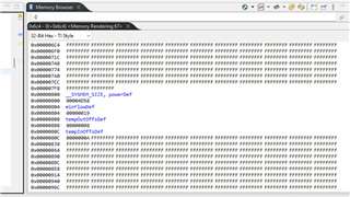

I would like to ask how to write data at a specific address in memory. I used:
__attribute__((used)) __attribute__((section (".controllerData"))) const uint32_t powerDef = 19800;
__attribute__((used)) __attribute__((section (".controllerData"))) const uint32_t minFlowDef = 25;
__attribute__((used)) __attribute__((section (".controllerData"))) const uint32_t tempOutOffsDef = 8;
__attribute__((used)) __attribute__((section (".controllerData"))) const uint32_t tempInOffsDef = 10;
But these data are written consecutively in the memory.
I would like to choose exactly which address individual data should be written to.
Thank you for any support.
