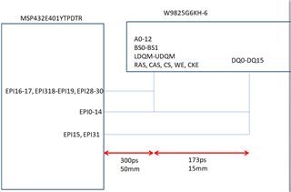

I need to connect an SDRAM memory to the MSP432E401Y through the EPI interface,
1-) Can I use the W9825G6KH-6 memory? Is it compatible with the EPI interface?
2-) I attach the connection diagram between the SDRAM memory and the MSP432E401Y. Is the attached schematic correct? Note EPI0S0-12 is shared between address bus and data bus, while EPI0S13-14 is shared between data bus and bank select. Is this correct?
3-) Does the schematic require additional components such as termination resistors or something else (I am referring only to the part related to the memory)?
Thanks very much. Best regards.
    I don't see an issue interfacing with EPI.
    I don't see a problem as far as EPI0S0-12 and EPI0S13-14 connections.
    There is a TI Reference Design with TM4C129 and SDRAM where you can find the schematic, layout and software collaterals.
    https://www.ti.com/tool/TIDM-TM4C129XSDRAM
    No termination resistors are called for but please follow the best practices as outlined in the System Design Guideline.

    I have rotated the RAM so that EPI0-14 go first through go first to A0-12,BS0-1 and then go through DQ0-15. I have equalized the line delays so that the signals up to A0-12,BS0-1 have a delay of 300ps (approximately 50mm) and continue to DQ00-15 with a delay of 173ps (approximately 15mm). I show the idea in the attached schematic.
    1-) Is the idea of the schematic correct?
    2.) Although the memory is 166MHz it will work at 60 MHz which is the speed of the EPI bus ?
    Thanks very much. Best Regards
  • HI,
      I don't see an issue.
