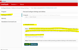

    Yes, you can use Uniflash or CCS to erase the main flash array. See below.
    If you want to also erase the non-volatile registers such as BOOTCFG then you must perform a "Unlock" operation which will not only erase the flash array but also the non-volatile registers and EEprom to its factory setting.

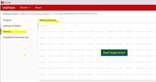

    Yes. You can do it in various ways. You can view the flash content in CCS by opening a Memory Browser window or use the Uniflash to read the content. See below.
