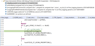

I finally found the root cause of the application spurious crashes, it was a DABT on address 0xFFFFFFB0.
After further research, I saw that this error was raised in FreeRTOS xTaskResumeAll() function. Sometimes, when taskYIELD_IF_USING_PREEMPTION() is called, the CPU is still in user mode!
I changed the routine to check current mode and raise to system mode when required.
Now the software works without any failure.
What I cannot understand, is why sometimes CPU is in user mode at this moment.
Is this a known issue?
  • I have spent a little more time on this issue.
    I saw that the exception is triggered during pvPortMalloc() call (cf. screenshot below):
    This is a wild hack, so I change it to something less "dangerous".
    I changed the definition of portYIELD_WITHIN_API() to this:
