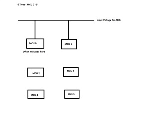

In a two-channel system A and B, with three TM4C123BH6 (BGA 157) per channel measure analog signals.
Measuring current of max. 3A, it is an accuracy of 0.1% deviation between the channels and against an external measurement required.
We have a problem with the ADC inputs. For example A0_I on MCU0 (PD5) measures 3 to 5 digits wrong. All other ADC imputs on this MCU have the same behaviour.
It's sporadically, tempereture has no impact and when the failure occures it is constant till the next restart.
The test software is as minimal as possible. The ADC and two GPIOs with LEDs there are configured.
The electrical design is not perfect, but the placement is almost identical, only the routing is different.

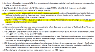

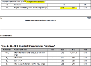

    3 to 5 LSB of error is a lot.

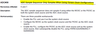

    What is your clock source to the ADC? There are several known ADC errata and see if they apply to you. Please also go through errata sheet at https://www.ti.com/lit/pdf/spmz849 for details.

    One step is equal to 3.3/4096 = 0.806mV. If you measure 3mV for an 5mV input then the error is (5-3)/0.806=2.48LSB. But if you are measuring 0V with an 5mV input then it is 5/0.806=6.2LSB and I agree this is over the spec.

    I'm interested to know if the errors you are seeing is only for low voltages on AIN or you see the same with other input voltages such as 1.65V or 3.3V?
     I do want to point out that for low voltage input, the amount of nonlinearity error will be usually higher. The below link has some discussion about it.

    Normally for best ADC performance the below options are recommended but I believe you have done some of them already. Again, please bear in mind the intrinsic linearity error as specified in the datasheet.
    • Use external Vref
    • Have separate VDDA and GNDA from VDD and GND
    • Adding RC filter.
    • Short trace of the input signal
    • Add a unity gain buffer driver
    • Oversampling/Averaging of the input. TM4C123 has a hardware sample averaging circuit

      Can you show me the raw data that you measure at 0V, 5mV, 1.65V and 3.3V for the problem board vs. the good boards?
      Can you do a ABA swap test by swapping the suspected MCU to one of the other five boards that you said have no issues? Please do the same by swapping the MCU on one of the five working boards to the suspected board.
     Although not likely to explain the problem, can you show Lot Trace Code on the six chips?
  • Hi Charles,
    it seems like we haven't explained something quite right yet.
    It's about multiple boards, that's right. There are 6 Tivas on each board.
    Always one Tiva (the same in terms of position) reliably has the error.
    For the others, the error occurs much less frequently or not at all.
    The error only occurs when the board is completely restarted or when the Tiva is SysCtlReset().
    We've also tried resetting just the ADC peripherals, but that has no effect.
    I will carry out the measurements again later, then I will write the desired ADC raw values ​​here.
  • it seems like we haven't explained something quite right yet. It's about multiple boards, that's right. There are 6 Tivas on each board.
    Hi Benjamin,
      Sorry for my past misunderstanding. You are saying each board has six Tiva and you have multiple of such board. It is always the MCU0 that is giving an undesirable ADC measurement no matter which board you use. The MCU1,2,3,4,5 are mostly correct on the boards. Is that a correct understanding? If that is the case, something is peculiar on the physical position of MCU0 vs other Tiva MCUs on the boards.
  • Hi Charles,
    Yes, the hardware is slightly different.
    The strange thing is that the error then occurs permanently.
    But it's enough to restart the tiva with SysCtlReset() and the error is gone.
    More precisely, the "raffle" starts again - it may be that the error occurs
    again immediately or only after several restarts of the Tiva.
  • Hi Benjamin,
      Can you do a ABA swap between the MCU0 and MCU5? I'm curious to know if MCU5 will suddenly exhibit the same issue like MCU0 while MCU0 becomes normal once moved to the MCU5 position.

    In my tests I could now see that the MCU0 is drifting downwards and the MCU1 is drifting upwards.
    It happens much more often in the MCU0, which is why the MCU1 hasn't been noticed until now.
    I also noticed that the MCU0 doesn't drift up, only down, and the MCU1 that it drifts down, not up (I stopped the tests after about 1000 restarts)
    So far, 3 of the boards tested have this behavior.

    What clock source do you provide to the ADC? Can you try to use MOSC as the clock source for ADC?

    I suppose you use the ADCClockConfigSet() to configure PIOSC as the clock source for ADC. Is that correct? Is the below how you call the API? If not, can you provide the exact API call you use?
    ADCClockConfigSet(ADC0_BASE, ADC_CLOCK_SRC_PIOSC | ADC_CLOCK_RATE_FULL, 1);
    What was the clock you used before?
