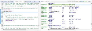

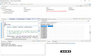

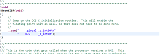

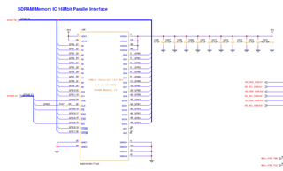

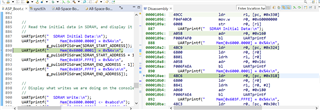

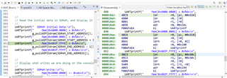

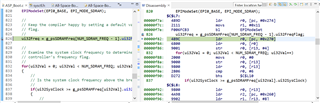

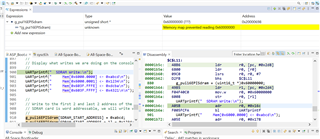

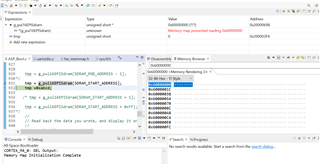

I trying to up EPI0 module communicated with external SDRAM
Following is the code iam using to test in TM4C1294NCPDT
but it always reset after the prints, It is not problem with the uart , uart4 is working fine but dont know the reason why it is resetting
This is my external ram code

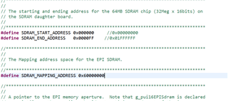

// The starting and ending address for the 64MB SDRAM chip (32Meg x 16bits) on
// the SDRAM daughter board.
#define SDRAM_START_ADDRESS 0x00000000
#define SDRAM_END_ADDRESS   0x01FFFFFF
// The Mapping address space for the EPI SDRAM.
#define SDRAM_MAPPING_ADDRESS 0x60000000

hardware connection diagram
This is the external RAM part number
IS45S16100H-7TLA2
can you please help me to solve the issue

    void
    ResetISR(void)
        // Jump to the CCS C initialization routine.  This will enable the
        // floating-point unit as well, so that does not need to be done here.
        __asm("    .global _c_int00\n"
              "    b.w     _c_int00");

        HWREG(NVIC_VTABLE) = (uint32_t)g_pfnVectors;
        SysCtlReset();
    // This is the code that gets called when the processor receives a fault
    // interrupt.  This simply enters an infinite loop, preserving the system state
    // for examination by a debugger.
    static void
    FaultISR(void)
        // Enter an infinite loop.
        // UARTprintf("Fault Encountered Restarting Software");
        SysCtlReset();
    // This is the code that gets called when the processor receives an unexpected
    static void
    IntDefaultHandler(void)
        // Go into an infinite loop.
        // UARTprintf("Unexpected Interrupt Encountered Restarting Software");
        SysCtlReset();
    All these above steps I did with my custom board
    When I test this code with EVK Tm4c1294xl , where not external RAM is connected , just to check how the code is working
    it always getting rested
  • this is what is happening
    1.
    2.
    3.
    4.
    5.
  • Custom board connection
  • On a high level I know why you are getting a reset. The reason is that you added code to generate reset when a FaultISR is entered.  Our default FaultISR in the startup file only spins forever and will not generate reset. The fault is most likely due to accessing the address SDRAM_END_ADDRESS. What is your  SDRAM_END_ADDRESS and what is the amount of SDRAM space you program the EPI module? If your SDRAM_END_ADDRESS is more than the SDRAM space you allocate for EPI module then it will generate a fault.
    Note today is a public US holiday for TI. Please expect delay in my response.
  • this is the address iam using Is it correct or any changes to be made ?
  • Please confirm the below questions.
    Do you get a fault with g_pui16EPISdram[SDRAM_START_ADDRESS])?
    Do you get a fault with g_pui16EPISdram[SDRAM_START_ADDRESS + 1])?
    Do you et a fault with g_pui16EPISdram[SDRAM_END_ADDRESS ])?
    Do you get a fault with g_pui16EPISdram[SDRAM_END_ADDRESS - 1])?
    Why don't use first assign the sdram data to  variable before printing? I want to see if you are getting a fault with the below code.
    uint16_t tmp;
    tmp = g_pui16EPISdram[SDRAM_END_ADDRESS];
    tmp = g_pui16EPISdram[SDRAM_END_ADDRESS - 1];
    tmp = g_pui16EPISdram[SDRAM_START_ADDRESS];
    tmp = g_pui16EPISdram[SDRAM_START_ADDRESS + 1];
    tmp = g_pui16EPISdram[SDRAM_START_ADDRESS + 0xFF];
    Please turn OFF any compiler optimization.
  • optimisation is off only
  • Still it is not working

    What is not working? Please clarify.
    I see tmp in the expression window showing 0. Is this after you run tmp = g_pui16EPISdram[SDRAM_END_ADDRESS] or after you run tmp = 0xabcd?
    Or are you complaining that the memory window is not showing the SDRAM content at 0x60000000? You need to update the GEL script for the debugger to see this region. Please also bear in mind that before the EPI and the SDRAM memory is initialized, you cannot use the debugger to read the SDRAM.
    Why don't you observe the EPI signals on a logic analyzer. Do you see anything like the address or data toggling?
