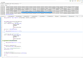

    It happens frequently, and no error happens.
    This is write_flash after set 0x0F.
    This is read_flash soon after reading flash.
    And this is a log this time.
    Best regard,
    Oyama
  • Hello Oyama,
    Thanks for the screenshots and the information. Since I could not reproduce this issue at my end, I would ask you to try out the following steps to identify the cause for this issue.
    1. Please flash the application and check if the application runs without any error messages. Load the .appimage in UART boot mode using the UART uniflash python script and when flashing is done change to OPSI boot mode and reboot.
    2. Please check if there are any flash configuration mismatch in syscfg when compared to SDK example flash configurations.
    3. Please use a different offset in the flash to check if same error can be reproduced at different offsets in the flash.
    4. If you have another AM243x LP hardware, then check if the same error can be reproduced.
    5. Try with the default EtherCAT SDK example without any additional modifications except writing and reading to/from the flash.
    6. Try to download and upload a sample file via FoE and compare the files to check if there is a data mismatch.
    Kind Regards,
