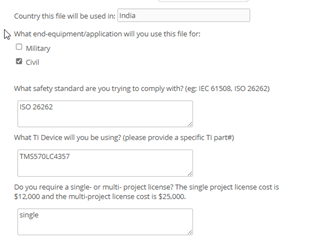

5. The TI Software Approval page for the SAFETI-HALCOGEN-CSP package details that a "single project" license costs $12,000 and the "multi-project" license cost is $25,000. To confirm are these prices up to date and in USD? Additionally, what does a single project constitute? Is this related to a single CCS project or a single user? Please provide information regarding the required license for a small development team.
