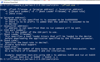

    You can use LM flash programmer. See below.
    Or you can use the command line sflash.exe which you can find at C:\ti\TivaWare_C_Series-2.2.0.295\tools\bin

    I tried sending the binary file using sflash.exe, but it got stuck. I first flashed boot_serial using JTAG.
    MEMORY
    FLASH (RX) : origin = 0x00000000, length = 0x00010000
    SRAM (RWX) : origin = 0x20000000, length = 0x00010000
    Then, I built boot_demo1 and attempted to send the binary using the below command.
    #define APP_BASE 0x00004000
    #define RAM_BASE 0x20000000
    MEMORY
    FLASH (RX) : origin = APP_BASE, length = 0x000fc000
    SRAM (RWX) : origin = 0x20000000, length = 0x00040000
    Command used:
    .\sflash.exe boot_demo1.bin -p 0x00004000 -r 0x20000000 -c 7 -b 115200 -s 1224
    When I use the -h option, I can see the help console, which confirms that the .exe file is executing properly. But I am not sure why it is hunged while giving above command.

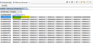

    I initially missed the offset 0x4000, but now it is working for me. I am able to flash boot_demo1.bin using the LM Flash Programmer. However, when I press the SW1 button, it goes back into bootloader mode.

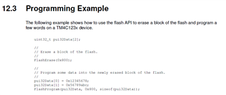

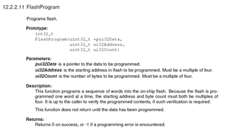

    Is it possible to hard code my BLINKY's binary data as hex values in updater function as array and write this values in flash 0x00004000 will this works, I am taking this hex values values from binary using hexdump tool.

    FlashProgram( BLINKY_bin, 0x4000, BLINKY_bin_len);
    If there is already data at 0x4000 then you must first erase the flash using FlashErase() API.

    int32_t result2 = FlashProgram(BLINKY_bin, address, sizeof(BLINKY_bin));
    if (result2 == 0) {
    // Flash programming was successful
    } else {
    // Error in programming flash
    return 0;

  • The function looks fine to me. Refer to the example below.

    I have verified my modified Blinky binary application (0x00004000) memory address in the memory browser in CCS. The first address (0x00004000) has the value 0x20000200, and the last address (0x000044C4) has the value 0xE7FEE7FE.
    Similarly, I have framed my binary array and correctly written the values to 0x00004000 using my current application running at 0x00000000. However, I received return values of 0 for both the erase and flash APIs. I checked the memory browser after erasing, and the values at 0x00004000 became 0xFFFFFFFF. After writing, the values were correctly placed, similar to the actual Blinky application. The first address (0x00004000) is 0x20000200, and the last address (0x000044C4) is 0xE7FEE7FE.
    I have attached the image below.

    Hi Charles,
    Thanks for the support,
    Below logic worked for me, once the value is written I am using below line to pointing my code  in main function
    uint32_t app_start_address = 0x00004000;
    uint32_t *vector_table;
    uint32_t stack_pointer, entry_point;
    vector_table = (uint32_t *)app_start_address;
    stack_pointer = vector_table[0];
    __set_MSP(stack_pointer);
    entry_point = vector_table[1];
    ((void (*)(void))entry_point)();

    int Perform_OTA(void) {
    uint32_t BLINKY_bin[] = { -------------Heaxa data---------------};
    uint32_t address = FLASH_START_ADDRESS;
    int32_t result1 = FlashErase(address);
    if (result1 == 0) {
    UART6Write((uint8_t *)"Erase successful\r\n", 16);
    } else {
    UART6Write((uint8_t *)"Erase unsuccessful\r\n", 18);
    if (result2 == 0) {
    UART6Write((uint8_t *)"\r\nFlash successful\r\n\r\n", 20);
    } else {
    UART6Write((uint8_t *)"Flash unsuccessful\r\n", 18);
    return 0;

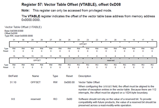

  • When the CPU comes out the reset, it  boot from a vector table at address zero. Refer to the Arm Cortex-M4 TRM. https://developer.arm.com/documentation/ka001197/latest/
  • Hi Charles,
    let me check the document, is there any options to achieve this?
  • You can change the processor's vector table address. Refer to the device datasheet. You can also refer to the bl_startup file for reference on how to change the vector table address.
    On system reset, the vector table is fixed at address 0x0000.0000. Privileged software can write to
    the Vector Table Offset (VTABLE) register to relocate the vector table start address to a different
    memory location, in the range 0x0000.0400 to 0x3FFF.FC00 (see “Vector Table” on page 119). Note
    that when configuring the VTABLE register, the offset must be aligned on a 1024-byte boundary.
    Also refer to the Arm TRM on this subject.
    https://developer.arm.com/documentation/107706/0100/Use-case-examples/General-information/What-does-the-program-image-contain-/Relocating-the-vector-table
