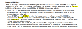

MSPM0L1305: DACCTL, contradictory definitions in TRM slau847d
Part Number: MSPM0L1305
In order to let the COMP output control the selection between DACCODE0 and DACCODE1 (for hysteresis), the DACCTL bit in CTL2 should be 1 according to Sect. 15.2.8 but 0 according to Sect. 15.3.24. Which one is correct. I already have submitted document feedback.
  • Hello Rainald,
    I have doubled check it. In fact, in the chapter 15.2.7, it also mentioned that setting 0 to the DACCTL bit in the CTL2 register is to let COMP output control the selection of DACCODE0 and DACCODE1.
    Then I double checked it in the SDK, it also shows that setting 0 to the DACCTL bit in the CTL2 register is to let COMP output control the selection of DACCODE0 and DACCODE1.
    Please take the SDK as reference. And I will submit Jira to fix the error in the Sect. 15.2.8 of TRM.
    Much thanks to point this error.
    Janz Bai
