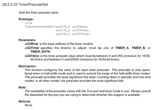

    You need to use TimerPrescalerSet to configure the presacler.
  • I am actually trying to measure the duty cycle of the signal. I am trying to measure it by dividing the pos-neg edge time difference and pos-pos edge time difference. The pos - pos_prev should give me total and (neg - pos_prev)/(pos-pos_prev) should give me duty cycle. However, it does not line up with data I am seeing for those times. The neg edge time is always higher than all three and pos_prev is higher than pos. I dont understand how that is possible.

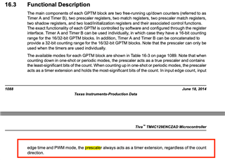

    Regarding prescaler, reading through the documentation:
    From what I understand, in edge time mode, the prescaler byte is an extension of the 16 bit timer, making it a 24 bit timer, since it holds the most significant bytes of the count. By that logic, I need to extract 24 bits or 0x00FFFFFF like I have done in the code. Correct me if I am wrong in my understanding.
  • I just tried TimerPrescaleSet to 4, and I still see the same values and the same difference between the values so it didnt really prescale anything. Then I tried checking the prescale register during the operation to see if it holds the 8 most significant bits of the count and it doesnt do that either and always reports 0. It is neither acting as an extension or an actual prescaler. Not sure what is going on here.

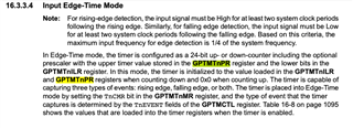

     Can you try the below.
    TimerPrescaleSet(TIMER0_BASE, TIMER_A, 0xFF);
    TimerLoadSet(TIMER0_BASE, TIMER_A, 0xFFFF);
    This will create a full 24-bit timer since the preload value would be 0xFF_FFFF. The free running counter will count from 0 to 0xFF_FFFF before it resets to zero again. The 24-bit counter gives a maximum 139.25ms at 120MHz.
  • That got the timer extended. Thank you. And I think it did also solve the problem because the root cause was prescaler the whole time. I still am confused though because I went over the document so many times and I couldn't figure this trick out. Was this written in the documentation somewhere that I missed?
      The preload value defines the upper limit beyond which the counter will reset when counting up to from 0. By setting the preload value to FF_FFFF this gives the counter a maximum of 24 bits to count up to. When counting down, the preload value defines the starting value for the counter. After the counter reaches zero, it is reloaded with the programmed preload value again. I understand the d/s is not very clear on the input capture time mode for counting up.

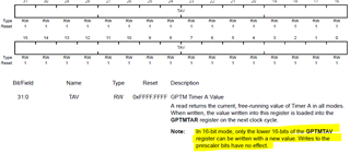

    I am still facing a problem with timer reset in the TimerEdgeTime mode. This is what my timer reset function looks like:
    void
    TimerReset(uint32_t ui32Base, uint32_t ui32Timer)
    if((ui32Timer & TIMER_A) == TIMER_A)
    HWREG(ui32Base + TIMER_O_TAV) = 0x00FFFFFF;
    if((ui32Timer & TIMER_B) == TIMER_B)
    HWREG(ui32Base + TIMER_O_TBV) = 0x00FFFFFF;
    This however does not reset the timer to 0. Not sure why?
    This is the documentation I am referring to
    It clearly says I need to write to the TnV registers, but it does not work. I also tried:
    TimerDisable(TIMER2_BASE, TIMER_BOTH);
    TimerPrescaleSet(TIMER2_BASE, TIMER_BOTH, 0xFF);
    TimerLoadSet(TIMER2_BASE, TIMER_BOTH, 0xFFFF);
    TimerEnable(TIMER2_BASE, TIMER_BOTH);
    but that does not reset the timer also. It would be great if I could get help on this. If I need to create a separate post let me know.

    When you write to GPTMTAV register, the value loaded into the GPTMTAR register on the next clock cycle. GPTMTAR register holds the number of edges that have occur. For example, if the timer has detected 10 edges then the GPTMTAR register will hold the value of 10. Why are trying to write to GPTMTAV register? Let's say you write 100 to GPTMTAV, on the next cycle, the value of 100 is loaded to GPTMTAR. In another word, the GPTMTAR register will change from 10 to 100? What is your purpose doing do? If you want to reset GPTMTAR, why don't you write a 0 to GPTMTAV register?
    Also be aware of the below note that the upper 8 bits have not effect when written.
  • Sorry for such a delayed response. Well I actually want to write 0 to the register and that is not working either. The TAV value never zeros out. It still continues from the last value it had. I have also tried enabling and disabling the timer and load setting in between to get it to start from 0 again and that does not work either.
