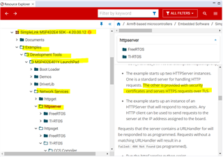

      We don't have any mqtt example with client certificates. However, looking at the https server example, it has code to show how CA cert of client is being used. Can you take at look at the HTTP example?
    In the httpSrvBasicHooks.c file, the example client certificate is included.
