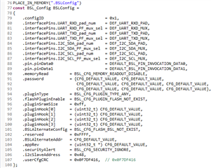

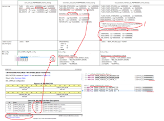

My Current Understanding of BSL:
  1. My project (using the default mspm0g1507.cmd) can already be updated using the BSL_GUI_EXE tool.
  2. The internal boot ROM runs first and utilizes BCR and BSL config settings, which can be configured. It may also reference the .vtable, though I am uncertain.
  3. BSL-related example projects contain boot_config.c, which defines BCR and BSL configurations, and each project has different memory layouts in the linker file. check the figure attached
  4. BCR configuration has an option to enable or disable SWD.
  5. The internal boot ROM determines whether to execute the built-in BSL or use a BSL plugin.
  6. The BSL plugin has an Init function, which can be used to configure the UART baud rate.
  7. The BSL configuration allows specifying a secondary bootloader, which can bypass the built-in BSL.

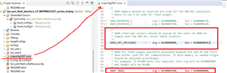

Questions:
  1. Does the boot ROM run completely independently by default? If not, does it rely on .vtable? If it does, how does it access the vector table, considering different projects place .vtable at different locations?
  2. Why do different projects have different SRAM start addresses (0x20200000 vs. 0x20000000)? What determines this?
  3. To change the BSL UART baud rate, do I need to use the plugin Init function? If so, do I also need to provide the Send, Receive, and Deinit functions?
  4. How should I modify my linker command file (.cmd) to incorporate the above requirements?

  • Hi Diego,
    Thanks for your response.
    I still have a few remaining questions that I’d like to clarify. Could you help explain them further?
    1. For 1. I’m still confused about why the linker file in the BSL_interface project mentions that the vector table must comply with the internal BSL vector table. Could you clarify this?
    2. Could you explain why standard MSPM0G3507 projects have their SRAM starting at 0x20200000, while BSL-related projects use 0x20000000?
      • What is the actual physical SRAM address for MSPM0G1507 and MSPM0G3507?
      • How does this difference impact memory allocation?
    I very appreciate your insights!
  • Hi Zhuang,
    1. This is just a requirement you need to follow. It's a design choice.
    2. The reason is that BSL always requires the use of the 0x2000 address in SRAM (after clearing that section). If not used in this region, BSL won't work as intended. The actual physical address is SRAM for both G devices is in  Table 1-2. SRAM Region Memory Map in the Userguide. The difference between one address and the other is the type of integrity checks applied to the access.
    Diego Abad

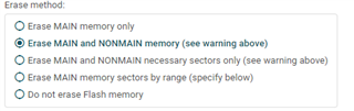

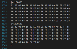

    I am trying to change the BSL password in my project. After modifying it and recalculating the new CRC, I am unable to successfully flash the firmware.
    To troubleshoot, I attempted flashing the BCR and BSL sections with default values, which match the factory constants. However, when flashing the .txt file using UniFlash (with "Erase MAIN and NONMAIN memory" checked), the process still fails.
    I have attached a screenshot for reference.
    Could you guide me on how to properly integrate the BCR and BSL sections into my project and correctly change the BSL password?
