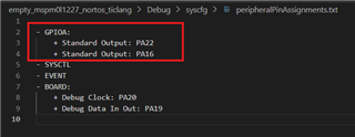

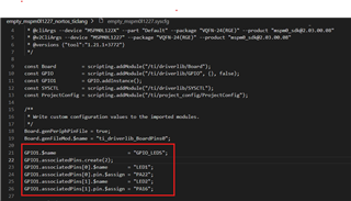

My customer has a question about the Table 6-2. Pin Attributes in the datasheet.
There are the columns of PIN NAME/IOMUX REG/IOMUX ADDR in the table.
They tried to set the address of PA16 listed in the page 18 by using the CCS, but PA15(DIO15) was set. Also, when the address of PA22 listed in the page 18 was set, PA21 (DIO21) was set.
They’re wondering that the addresses described in the datasheet are wrong. Are they correct ?
