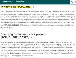

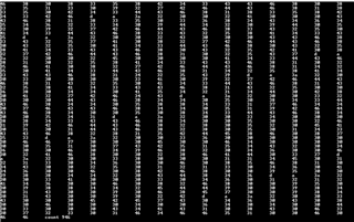

I am trying to do firmware upgrade via Ethernet , but the problem is I could receive only 964 bytes more than that I could get only "0" ,
How can I increase the buffer size using LWIP
what change to be done in the lwipopts.h file for increasing the Rx buffer size
please help me to resolve this issue

#define LWIP_TCP                        1
//#define TCP_TTL                         (IP_DEFAULT_TTL)
#define TCP_WND                         65500//4096   // default is 2048
//#define TCP_MAXRTX                      12
//#define TCP_SYNMAXRTX                   6
//#define TCP_QUEUE_OOSEQ                 1
#define TCP_MSS                        1500        // default is 128
//#define TCP_CALCULATE_EFF_SEND_MSS      1
#define TCP_SND_BUF                     (4 * TCP_MSS)

  • but my receiving window is large
    but still I can receive only 964 bytes correctly after 964 iam getting zeros only
    but in wireshark I can get all the bytes send from terminal
     I don't think TCP_WND is what you want to change. I think in your application, you should have a buffer that receives data from stack. You should increase that buffer size in your application instead of changing the lwIP stack configuration. Try that first.
