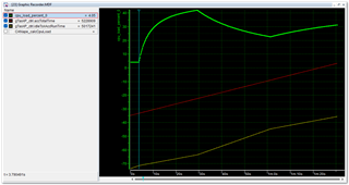

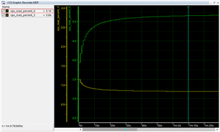

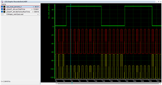

I'm reading the value of TaskP_loadGetTotalCpuLoad() in two cores at 1s intervals. configGENERATE_RUN_TIME_STATS=1. The FreeRTOS is from SDK 09_02_00_56.
Core 0 has FreeRTOS with some CAN code but not much else. Core 3 has only FreeRTOS with some tasks scheduled.
The problem is that the CPU load calculation is heavily filtered. It takes about a minute to reach a steady value. Is there any way I can tweak it to respond more quickly? I don't mind a bit of noise.

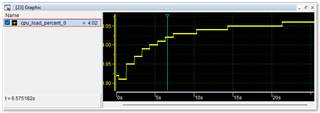

    I changed the tick rate to the same as the SDK (1000Hz) and switched off TICLESS_IDLE (whatever that is) but it makes no difference:
    Also, it doesn't seem to be related to the frequency of calling TaskP_loadGetTotalCpuLoad(). If I call it at 20ms, it makes no difference which is what we'd expect I suppose.

    On evaluating "TaskP_loadUpdateAll" and "TaskP_calcCpuLoad" function which is called by the "TaskP_loadGetTotalCpuLoad" function, I do see some filtering taking place
    The accumulated runtime seems to be continuously growing which might cause slow CPU load calculation (taking time to stabilize)
    The accTotalTime variable keeps growing over time, meaning new updates have a smaller relative impact. The difference (delta) is calculated based on the last recorded time. If updates happen infrequently, large delta values create a “lag” before the new load stabilizes.

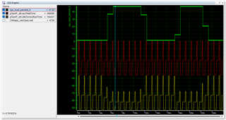

  • Hi Shaunak,
    Many thanks for your investigation.
    FYI, I noticed that the problem gets progressively worse.
    I programmed a large step change in CPU load (approx 50%) that I could control externally. In the plot below, the initial CPU load is around 4%. I then switch on artificial high CPU load at ~4s and the load heads upwards, then off at ~30s then on again at ~60s. The filtering gets harsher as time goes by. I imagine that after a few minutes, CPU load calculation is practically stuck.
    I don't think this continuous accumulation is necessary. It just needs to accumulate between each CPU load call. At the end of each call, the counters can (and should in my view) be reset.

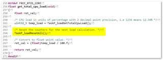

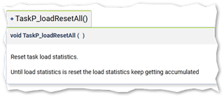

    Taking your lead, I noticed that the function TaskP_loadResetAll(), in which the relevant counters are reset, is never called in the SDK implementation. I figured that the after each load calculation window (TaskP_LOAD_UPDATE_WINDOW_MSEC), that calling TaskP_loadResetAll() would do the trick:
    And it certainly does. Now I get an almost instantaneous change in calculated CPU load (to ~50%) for my actual step change in CPU load:
    From here it looks like the call TaskP_loadResetAll() is missing in the SDK implementation.
    Thanks for testing and sharing this.
    Let me talk to some other FreeRTOS experts who might know why this is the case.
    Does calling TaskP_loadResetAll() at the end of load calculation window fix the filtering issue you were observing originally?
    Shaunak
  • Hi Shaunak,
    Perhaps it is the applicaton's responsbility to call TaskP_loadResetAll()?
    I have now reverted FreeRTOS and added this in my application:
    Of course I get similar (good) results:
    The API says the following:
    It's not clear from this description that, without calling this, the CPU load response will gradually grind to a halt. Perhaps that needs clarification?
    Anyway, the problem is solved! Thanks for your help.

    I've no doubt it is in the examples and that was my oversight. But I still think there is scope for improvement of the documentation. I think we have established that it is essential to call TaskP_loadResetAll(). If that is the case, your API documentation should mention that. It would have saved much of our time.
    Kier.
  • But I still think there is scope for improvement of the documentation
    Agreed, I will update the documentation to mention this.
