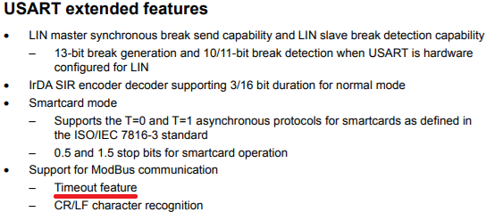

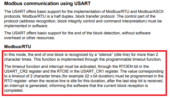

Hello !
The customer is expecting a “timeout feature” in MODBUS feature on OMAP2432 USART as described in the here below extract from a competitor device datasheet :
The Time out feature is characterized here below :
From a firmware point of view, this feature is a true game changer to offload CPU especially for higher baudrates.
Baudrates to be supported :
4800 (Customer), 9600 (Customer), 19200 (Customer), 38400 (Customer), 57600 (tools), 115200 (tools), 230400 (tools), 460800 (tools), 921600 (tools)
QUESTION : is there an equivalent function on AM243x or more generally TI UART HW IP blocks?
