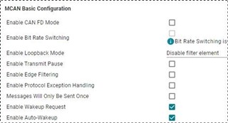

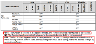

My customer is developing M0G3507. With below setting, M0G3507 can be wakeup from Seep mode by CAN bus. However, under Standby mode, M0G3507 cannot be wakeup by CAN bus . Please instruct if any configuration should be modified ?
Below show their setting on MCAN_INITParams.  "Enable Wakeup Request" is set.
