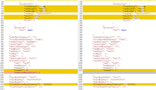

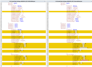

If I compare the settings with the {MCU_PLUS_SDK_AM263PX_INSTALLATION_PATH}/source/sysconfig/board/.meta/flash/IS25LX064.json, the following settings are different:
(the output of the ospi_flash_diag SDK example project is on the right side)
