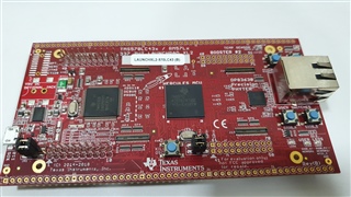

We have received a Rev (B) LaunchPad kit. The available documentation, however, pertains to Rev (A1). Could you please provide information regarding the changes between these two revisions?
Hi Kanika,
PCB wise there won't be any changes from Rev A to Rev B.
The only thing that changed from Rev A to Rev B is that micro controller silicon revision. On Rev A PCB they used Revision A silicon controller and on Rev B PCB they are using latest Revision B silicon controller.
And you can find the changes between these two silicon revisions in below errata sheet at section-3:
TMS570LC4x Microcontroller Silicon Errata (Silicon Revision B) (Rev. B)
For remaining everything, we can use same documents for both the PCB boards.
