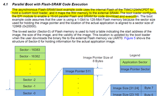

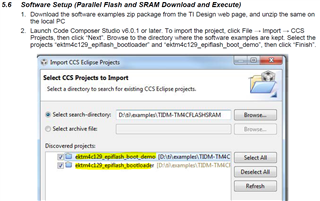

      Have you had a chance to reference the TI Reference design at:
    TIDM-TM4CFLASHSRAM - Concurrent Parallel XIP Flash and SRAM Design for code download & execution on High Performance MCUs. You can find the software collateral for this TI design at /cfs-file/__key/communityserver-discussions-components-files/908/tidcaj1.zip
    The above reference design software example uses the internal Flash of the TM4C1294NCPDT to hold a custom boot loader, and it maps the RW memory to the external SRAM. The boot loader configures the EPI module to enable a 16-bit parallel Flash and SRAM for code download and execution
    When I try to write in RAM section beyond the memory region allocated for execution Its is writing only "0" zeros.
    I don't understand your question. Your internal SRAM section only has a length of 0x00060000. Why are you trying to write beyond 0x60000?
    If you are writing to external SRAM at 0x60000000 then you need to make sure EPI module is initialized before you can write to it.
    Please take a look at the examples for the Reference design I pointed to above.

  • Are you going to run code out of external RAM or just reading data? You have the below line. This means you are going to run code out of the internal SRAM. If you are not running code out of external SRAM, then why do you need to remap the vector table to SD_RAM_BASE. Whether you are going to run code out of internal RAM or external RAM, you must first initialize the EPI module and then copy your code from flash to either internal RAM or external RAM for execution.
    .TI.ramfunc : {} load=FLASH, run=SRAM, table(BINIT)
    I strongly suggest you take a look at the TIDM-TM4CFLASHSRAM and the software colleterial. If you look at the example, the program image (ektm4c129_epiflash_boot_demo) is to be copied to the external flash through the EPI interface by the bootloader (ektm4c129_epiflash_bootloader). The program image merely has the below linker file. Once the program image is copied to the external flash, the bootloader will jump to the application at 0x60020000. The SRAM section is mapped to the external SRAM at 0xA0000000.

  • Then the TIDM-TM4CFLASHSRAM will be a good start point for you to reference. As mentioned, this example contains a custom bootloader called ektm4c129_epiflash_bootloader (see below) which will copy the example application called ektm4c129_epiflash_boot_demo to the external flash through the EPI interface. Once the code is copied to the external flash and RAM, the bootloader will jump to the external flash memory to start execution.

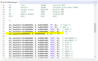

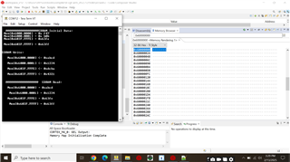

    This is my code I could able to write and read with this code
    It is showing like write and read in console
    But I could not access from memory browser
    Please see what changes to be made to code to view it in the memory browser

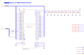

    // The starting and ending address for the  16Mb SDRAM chip (1Meg x 16bits) on
    // the SDRAM daughter board.
    #define SDRAM_START_ADDRESS 0x000000
    #define SDRAM_END_ADDRESS   0x7FFFFF
    // The Mapping address space for the EPI SDRAM.
    #define SDRAM_MAPPING_ADDRESS 0x60000000

    void sdRamReadWriteCheck( void )
        uint16_t testdata[10] = {0};
        // Set the EPI memory pointer to the base of EPI memory space.  Note that
        // g_pui16EPISdram is declared as volatile so the compiler should not
        // optimize reads out of the memory.  With this pointer, the memory space
        // is accessed like a simple array.
        g_pui16EPISdram = ( uint16_t* ) 0x60000000;
        // Read the initial data in SDRAM, and display it on the console.
        UARTprintf( "\n\r  @@@@@@@@@@@@@@@@@@SDRAM Initial Data:" );
        testdata[0] = g_pui16EPISdram[ SDRAM_START_ADDRESS ];
        UARTprintf( "\r\n Mem[0x6000.0000] = 0x%4x",testdata[0] );
        UARTprintf( " \r\n Mem[0x6000.0001] = 0x%4x",g_pui16EPISdram[ SDRAM_START_ADDRESS + 1 ] );
        UARTprintf( " \r\n Mem[0x603F.FFFE] = 0x%4x\n",g_pui16EPISdram[ SDRAM_END_ADDRESS - 1 ] );
        UARTprintf( " \r\n Mem[0x603F.FFFF] = 0x%4x\n\n",g_pui16EPISdram[ SDRAM_END_ADDRESS ] );
        // Display what writes we are doing on the console.
        UARTprintf( "  \r\nSDRAM Write:\n" );
        UARTprintf( "  \r\n   Mem[0x6000.0000] <- 0xabcd\n" );
        UARTprintf( "  \r\n   Mem[0x6000.0001] <- 0x1234\n" );
        UARTprintf( "  \r\n   Mem[0x603F.FFFE] <- 0xdcba\n" );
        UARTprintf( "  \r\n   Mem[0x603F.FFFF] <- 0x4321\n\n" );
        // Write to the first 2 and last 2 address of the SDRAM card.  Since the
        // SDRAM card is word addressable, we will write words.
        g_pui16EPISdram[ SDRAM_START_ADDRESS ] = 0xabcd;
        g_pui16EPISdram[ SDRAM_START_ADDRESS + 1 ] = 0x1234;
        g_pui16EPISdram[ SDRAM_END_ADDRESS - 1 ] = 0xdcba;
        g_pui16EPISdram[ SDRAM_END_ADDRESS ] = 0x4321;
        // Read back the data you wrote, and display it on the console.
        UARTprintf( "\n\r  @@@@@@@@@@@@@@@@@@  SDRAM Read:\n" );
        UARTprintf( "  \r\n   Mem[0x6000.0000] = 0x%4x\n",g_pui16EPISdram[ SDRAM_START_ADDRESS ] );
        UARTprintf( " \r\n    Mem[0x6000.0001] = 0x%4x\n", g_pui16EPISdram[ SDRAM_START_ADDRESS + 1 ] );

  • I don't have any external SRAM for Tm4c1294 EVK , but i have only custom SDRAM interfaced with  TM4C1294NCPDT
  • Any changes to be made in this .cmd file please review it

  • But I could not access from memory browser
    You need to check the GEL file. The default GEL file has only address from 0xA0000000 declared for EPI module, not 0x60000000,. You can modify the GEL file to also include address range from  0x60000000. Also note that you must have the EPI module initialized before you can let the debugger read the external memory.

    I have shown you the .cmd file for ektm4c129_epiflash_boot_demo. I don't know why you want to use your above .cmd file. Have you tried it yourself? I think it will confuse the linker. You have the .vtable and .data sections mapped to both the internal and external memories. Are you not getting errors?
