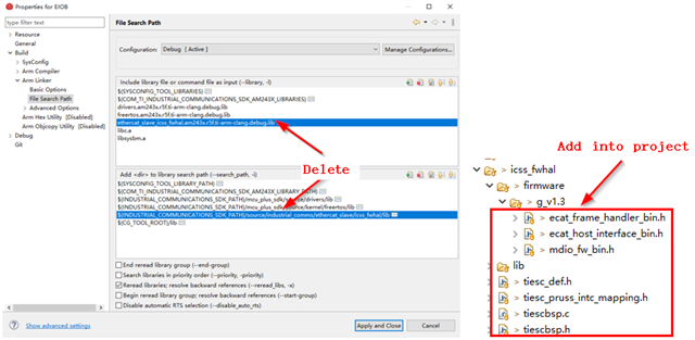

Customer is working on AM2432 SDK9.0.
They use the following default icss_fwhal source file to replace the lib file.
After replacing icss_fwhal lib file with source file, they recompile the source file, and add into the project below.
However, after doing so their Ethercat cannot enter OP anymore and the LINKSTA LED of PHY keeps blinking (previously it was working file if not replacing the icss_fwhal lib file to source file).
Customer does not know why, would it because that our default icss_fwhal lib file version is not the same as source file?

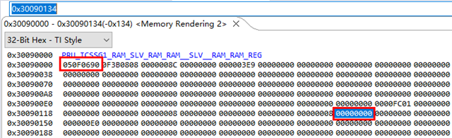

    Just to make sure that the EtherCAT firmware is loaded, could you provide the value in register 0x30090000 from the customer's setup? This register value will provide the EtherCAT Firmware version. Also please provide the value in register 0x30090134 register.
    Details of the above register values can be found in the following documentation: TI EtherCAT SubDevice Controller Register List
    Aaron
  • Hi Aaron,
    Thanks for your reply, customer did more testing recently and finally found this problem is related to the compiler optimization configuration.
    1: If the optimization is O0
    Result: Ethercat could enter OP normally without any problem.
    The register values for 0x30090000 & 0x30090134 are below.

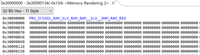

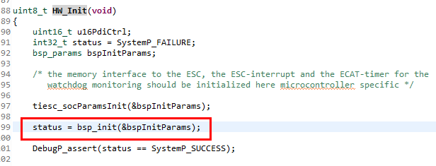

    2: If the optimization is O2
    Result: The program will crash at bsp_init() function (shown below), and Ethercat could not enter OP.
    The register values for 0x30090000 & 0x30090134 are both 0 in this case shown below.
    Could you please help provide some suggestions for customer why this happen?

  • Thanks Kevin for the details.
    So when the optimization is O2, the application is failing in bsp_init() and hence, the firmware is not getting loaded, hence EtherCAT communication is failing. I'll try to reproduce this from my side investigate further on what may be going wrong.
