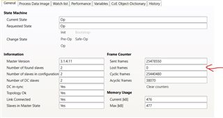

I have replaced that line for 2 or 3 hours. I have not observed any bad effects. EtherCAT cycle is smaller than 1 millisecond.
Measurement of cycle time seems to be totally fine (data not shared).

To my supporise, sync0 shows the same pattern as measured by toggling one gpio pin, which is 1 ethercat cycle time.
However, sync1 on J7.5 shows a frequency of 2 times ethercat cycle (data not shown).
I think sync1 signal frequency is wrong. How do you think?
For your information: I see the following values with another tool in real-time.
SM output parameter is 0x1C32:01 is 0x02 and 0x1C32:02 is 250000, and
SM Input parameter is 0x1C33:01 is 0x03, and 0x1C33:02 is 250000.
