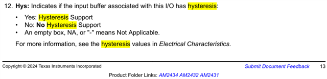

Hi TI Experts,
Customer is working on AM2432 SDK9.2.
They want to know, for the ALV package, if they configure pins C17, W5, D18 working in EQEP or ECAP mode, will the hysteresis feature for these pins be configured by default or not?
That is to say, if they want to support hysteresis feature on the above pins in EQEP or ECAP mode, do they need to manually configure anything to support this feature?
There is no much description in the TRM for this part, could you please help provide some guidance for us?
