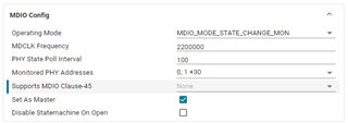

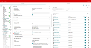

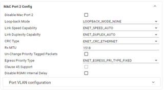

1. Follow the steps here to integrate the PHY not supported by the default SDK: https://software-dl.ti.com/mcu-plus-sdk/esd/AM263X/latest/exports/docs/api_guide_am263x/custom_enetphy_guide.html
2. The SDK can support clause-45 frame format as well, You can configure this in the example.syscfg file. Here in the "Supports MDIO Clause-45", enter your PHY address
and check the "Clause 45 Support" box in the MAC Port config

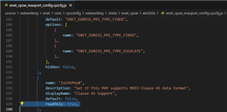

Hi ZX,
Apologies for a delayed response, can you also perform the following steps:
1. In the following Javascript file located at: mcu_plus_sdk/source/networking/enet/core/sysconfig/networking/.meta/enet_cpsw/am263x/enet_cpsw_macport_config.syscfg.js, Please remove the line-number-199 (readOnly: true)
2. After step-1, when you re-open the example.syscfg in your application, you will be able to check the Clause-45 Support checkbox. Rebuild your application.
3, In the MDIO_open function, set a breakpoint and ensure that the MDIO configuration is written correctly and CSL_MDIO_setClause45EnableMask is called to set the mask for Clause-45
Also, since the BCM89884 is a non TI PHY, make sure you take care of the PHY configurations (if any configs are required for the PHY to support Clause45) in the application. Also ensure the PHY Address is mentioned correctly in the application syscfg. This should be also visible in the Mdio_Cfg enetAppCpswMdioCfg in syscfg auto-generated ti_enet_open_close.c file

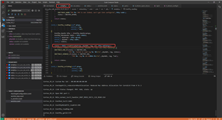

Hi :
After following your steps to modify, it can be confirmed that CSL_MDIO_setClause45EnableMask is called to set the mask for Clause-45, but the operation interface of phy is still docked with 22 by default,and we need to manually modify it to 45
Are there any other configuration items missing?
