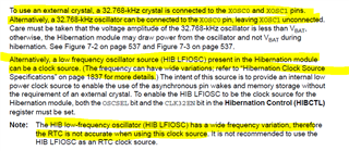

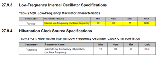

The RTCCLK can take the clock source among three different clock sources: See below. If you choose either the 32.768kHz OSC or the external 32.768kHz clock source (a direct square wave clock) then the RTC accuracy depends on your external crystal or the oscillator. You will need to find out the clock tolerance from your crystal/oscillator datasheet.
If you choose the internal low frequency oscillator (LFIOSC) then the tolerance is high. The

The accuracy of your external crystal can be affected by things like temperature changes load fluctuations, and even aging but I think they should be taken into account by the ppm that is specified in your crystal datasheet.
