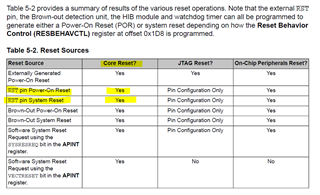

  • Hi Toru-san,
     Sorry, my bad. Reading the datasheet again, it looks like an /RST low will reset the Arm core regardless the reset pin is configured for simulated POR or System Reset.

    I think you can try out on a LaunchPad for experiment. On a LaunchPad, I first set up some breakpoints on a program. if I press the nRST pin then the debugger will be disconnected. I will have to reconnect with the target. Once connected, the breakpoints that I setup earlier were lost. This means a nRST pin will clear the Arm core debug logic.
    - If the /RST pin is asserted from HIGH to LOW while the C_HALT bit is set to 1, does the C_HALT bit clear to 0?
    Yes. Refer to my experiment above.
    - If the /RST pin is released from LOW to HIGH while the C_HALT bit is set to 1, does the C_HALT bit stay 1?
    This cannot be possible to begin with. While the nRST is active, the debug logic including the C_HALT bit will be reset to 0.
    - If power is applied between VDD and GND while the /RST pin is held LOW, will the CPU remain halted and not run?
    If the nRST pin is held low then the device is in reset state. It will not run.
    - Is it possible to set the C_HALT bit to 1 while the /RST pin is held LOW?
    No.
