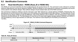

hello,Dear TI Team
I am using TMS570LC4357-EP to read the id of S25FL512S
I am using Multibuffer mode with number of buffers set to 6.
Following are my configurations:
1) Charlen = 8
2) CSHOLD Bit = SET
3) CSNR are set correctly.
4) All fields of SPIDELAY are set to 0.
5) Four pin configuration with CS, no enable pin
6) WDELAY field of SPI FMT register is set to 0
7)dataformat 3
Following are my code:

The timing of the S25FL512S is shown in the following figure
The result:
The data sent by MibSPI1 can be received by the external USB to SPI board, but the board will not send any data, strangely enough, MibSPI1 can receive some data.
Data sent by MibSPI1, S25FL512S will not return ID, rxbuff is all FF
Please help analyze the cause of the problem
Methods I've tried:C2TDELAY 2
