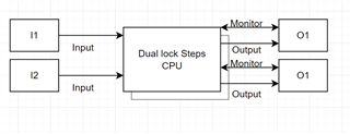

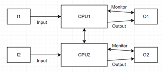

For category 3, the input and output should be connected to seperate devices, like shown below.
However, Hercules MCU (RM46 series) looks like single device.
Does GPIO seperated physically for 2 inputs and outputs?
