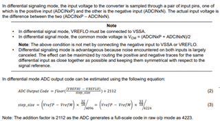

    I was wondering what is the common mode and differential mode ranges on the ADC modules in AM263Px Sitara package. The reason I'm asking is that we are utilizing the differential feature in the ADC (use the 3  differential pairs in one adc module to interface measured ac voltages/currents).Also, where I can find this information in the datasheet if they exist?
    Archie A.
  • Hey Archie,
    *Assuming VREFHI is 1.8 V.
    In Single Ended Mode:
    The voltage range is 0 to 3.3V.
    In Differential Mode:
    The common mode is defined as (Vinp+Vinm)/2 and must always be (VRefP*33/18/2 ± 25mV).
    The maximum positive input is when Vin+=3.3V and Vin-=0 and the maximum negative input is when Vin+=0V and Vin-=3.3V. This range is equally divided in 4224 levels by the ADC.
    Some of this information is located in the TRM (pg. 469). Note, screenshot taken from AM263x TRM which has updated equation figures (this will come in the next release of the AM263Px TRM). I agree this is something that should probably also be included in the datasheet. I will file a ticket for that and see what the team says.
