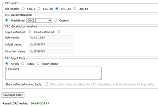

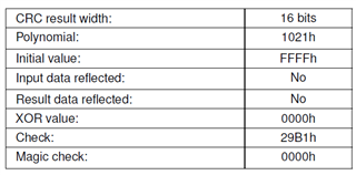

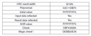

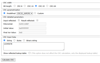

Our customer is trying to run CRCP against a standard IEEE 802.3 '0x04C11DB7' polynomial and test string {'1','2','3','4','5','6','7','8'}. That should generate 0xE3C97CBC CRC. But can’t really get it to work.

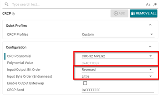

Ideally, one should be able to read and load this as 32b data with setting LE or as 8 bit regardless in but none of it gets correct result so far.
- Does CRCP stream 32b data byte-by-byte through the CRC engine or the whole 32b value is used?
- Any hints or suggestion on how to configure CRCP to get this right or maybe some pseudo code explaining how CRCP CRC engine works?
