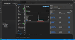

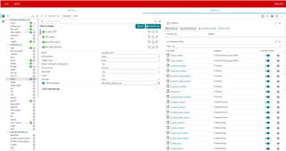

  1. syscfg
2. code

  • Hi zx
    We have been able to successfully debug this issue.
    It is being caused due to internal mux settings that need to be done to use these pins as GPIO instead of ICSSGPIO.
    From the schematic we can see that:
    • AM263_PRU_MUX_SEL_GPIO64 needs to be pulled high for PATH A <-> C (which is what we need)
    • AM263_MUX_EN_GPIO58 needs to be pulled high to enable this U23 mux
    to do these changes through sysconfig, we just added two more gpio configs
    for the above two switches respectively.
    This changed enabled those pins to be used as GPIO, and the program ran correctly.
    Please try these changes and let me know if your issue is resolved. For Control Card as well, some mux changes(maybe different) will be needed to be done, which can be found in a similar way through schematics.
