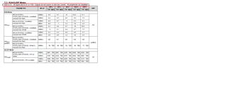

My customer is evaluating M0G3519. They want to know what's the maximum current consumption at run mode ?
On datasheet Table 7.5.1, is this max. value 11.1 mA based on test criterion ?

The maximum current consumption will vary depending on which and how many modules the customer uses. The table values reflect the typical current consumption at those specific test criteria. The G3519 has a recommended top current of around 100mA (refer to Table 7.1 Absolute Maximum Ratings), so it normally can't go beyond that.

Hi Diego,
Thanks for your reply. I will notify customer. If they need more information, I suggest customer to ask on E2E directly.
