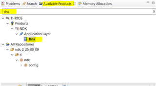

I'm modifying the 'httpget" TI-RTOS example in order to connect the dev kit to a local http server. I've been able to change the config to static IP via opening the .cfg file with XGCONF, but I haven't found a way to add a DNS server in the config file. Is there a way to do so?
Thanks!
      You can add the DNS module like below.
