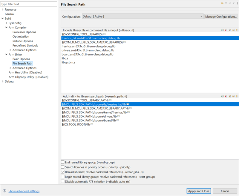

I am trying to add mmcsd/FreeRTOS-FAT functionality to the existing udpclient example from the SDK, so that I can read network config from a file on an SD card (this is the 243EVM board if that helps).
I was challenged to get the compiler to locate all of the appropriate headers, but now I'm getting a handful of ff_ functions showing up as unresolved symbols by the linker.
[127] undefined     first referenced

As I'm new to CCS, I'm pretty sure this is an issue with me not knowing how to tell the compiler and linker where to look for things, but I've already spent some time in the Project->Properties pages adding paths, etc. to no avail.
Thoughts?
Thank you!
    If the build errors are at the linker stage, it is possible you have not included a certain library. Please make sure you have included the "freertos_fat" library in your example.

    Unfortunately, that path is already part of my Linker settings within CCS' Project Properties dialog. What else might I try, please?
    In that case, please share the build logs to see the exact command being used for linking.

    I think this is getting me closer to the answer. I do not have that specific library in my linker output, even though I _do_ have the path in my linker settings. How do I address this, please?
    Please add the missing libraries to your project and rebuild the example. To add, open project properties.
    Navigate to Build -> Arm Linker -> File Search Path. Add the libraries as show below.
    Please refer below image.
    After making the above changes click on Apply and close and rebuild the project.

  • Thank you so much! I would never have found this option otherwise, and I'm very grateful you took the time to walk me through it.
