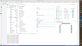

  • Hi Kai,
    Please share you whole DMA setting screenshot, I want to double check its setting.
    4) On DL_ADC12_IIDX_DMA_DONE I set the next address an reenable dma (DMA single Mode - Like the Ping Pong example)
    Why not firstly check the transfer size =1 /2 to see whether the output is correct.

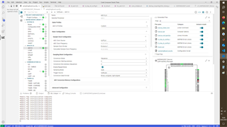

  • See screenshots below and some stripped down code for what I'm doing.
    Update wrt to my original post: the "wrong" values (300) are gone, but when I break the first time after the dma interrupt, mem0 is still not the first entry.
    Wrt to the transfer size, I noticed setting the transfer size to half the buffer size, I get a filled buffer, but still the ordering seems wrong. Since this would mean I have a dma samples count of 1, I added the explict setting of the sampls count in the main(), still the same result. It seems the dma samples count is ignored?

  • Hi Kai,
    Something is incorrect:
    You need set the DMA trigger as MEMRES11.
    That is correct. You enabled FIFO, and FIFO data is 32-bit which contains two sample result within one data (high 16-bit and low 16-bit).
    You need manually handle it in software, or you need select source/destination length as 16-bit.
    B.R.
    Sal
