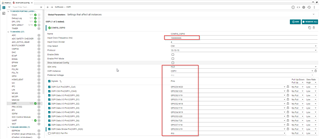

    Thanks for your reply. While I am using am261x MCU, instead of am263px. And I have switched CCS to version 12.8.1.
    But still, I met the same error. Running ospi flash diagnostic example of ospi0 is fine, but not working at ospi1.
    sysconfig
    error info
    Also, I tried to run ospi flash dual io example, the output info just like this:
    dual io error info
    So I still dont know whether the ospi1 can work or not.
    Is there anything else I need to modified to running these two examples?
  • Hi Shengzhe,
    Can you please share the example.sysconfig file. and screenshot of OSPI tab in sysconfig.
    From the screenshot above the input clock frequency looks wrong. Can you try making it 166666666 (166MHz
    Rijohn

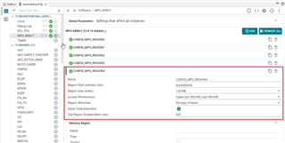

    9. Add new MPU region in sysconfig as in below image
    10. Confirm the OSPI instance is set to OSPI1 and Signals/Pins are set correctly as below:
    11. Save the example.syscfg file and build the application and run:
