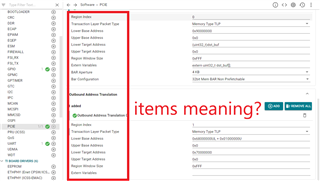

where can I get the explanation of the items meaning under inbound and outbound of .syscfg?
see the capture.

Hi Hongkai xiao,
Thanks for your query.
You can refer below section of AM64x and AM243x: MCU+ SDK-Based PCIe End Point
5.3 Inbound ATU and BAR Functionalities
5.4 Outbound ATU Functionalities
For more info please refer section "12.2.2.4 PCIe Subsystem Functional Description" of AM64x-TRM
