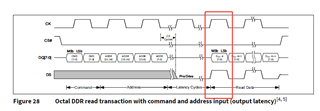

Flash datasheet:
https://www.infineon.com/dgdl/Infineon-S28HS512T_S28HS01GT_S28HL512T_S28HL01GT_512MB_1GB_SEMPER_TM_FLASH_OCTAL_INTERFACE_1_8V_3-DataSheet-v68_00-EN.pdf?fileId=8ac78c8c7d0d8da4017d0ee6bca96f97

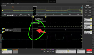

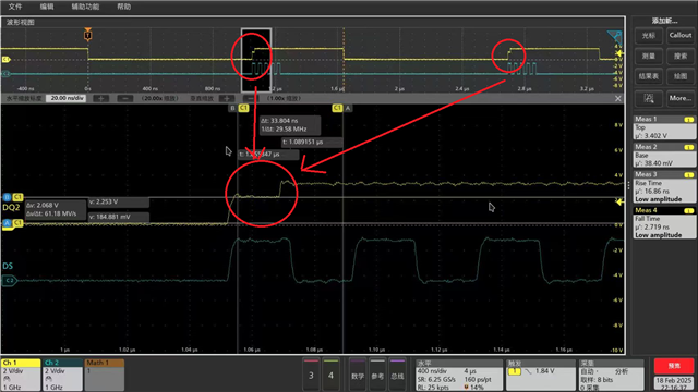

       The waveform when reading OSPI flash in 8D mode, found the high level of DQs pins does not reach VDD at the first data bit, as below picture.
Corresponding to the following mark .

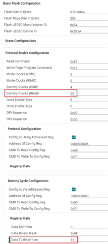

We think it may be due to this config value of sysconfig
Through ospi_flash_diag project, we can read out dummyClksRd = 24 from flash chip,  it is exactly one clock less that sysconfig value.
The host delayed a CLK release the DQs pins resulting in a half-level?
As test, change the value to 26, then extend one more CLK half-level, as show in the below picture.
Then change to 24, can't read value from flash correctly.
Now we would like to ask whether our speculation is correct, and how to eliminate this half-level issue?

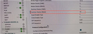

  • Update:
    With default OSPI configuration. "Protocol Enable Configuration"->"Dummy Clocks(READ)" = 25, but flash chip dummy register =24. But when i modefiy them to same such as 24 or 25 or 8, failed as read incorrect value from flash.
    So why the host dummy cycle need be larger than slave?

  • Hi Vaibhav,
    The key question is:
    How to configure dummy cycle for OSPI controller and device/flash. From test result, on controller side need to be 1 more cycle than device/flash side.
    The default sysconfig of OSPI example also set to this pattern, the reason and the basis?
  • Please set the dummy clocks read and dummy clocks command from the logs.
    This modthed doesn't work, I have already tried on S28HS512T/S28HL512T/MX25LM256.

  • Hi Vaibhav,
    It is functional,

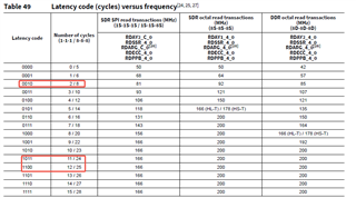

    #1. But the waveform is abnormal on the first data bit of reading. How to interpret the waveform of middle level.
    #2. 24/25 is for 200MHz, it is too larger and not necessary for 33.5MHz, waste cycles and lead low throughput.
    #3. Verified 5(flash)/6(soc) dummy cycle with 33.5MHz, it passed data write/read test.

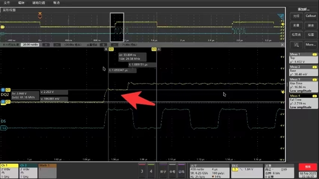

  • First bit of data stage of each Read transaction.
    Can capture it during OSPI booting also.
  • Corresponding to the following mark .
    As show in this picture, if the first readout byte equal to 0xff, you can reproduce this behaviour on all DQs pins
  • Hi Vaibhav, any update? Same issue can be reproduce on EVM board.
  • Hi Vaibhav,
    You thread told how to select dummy cycle number according to ospi clock frequency running.
    But my question is:
    #1. Why need to configure dummy cycle on controller side to be 1 more cycle than device/flash side. otherwise access fail.
    #2. With #1 get the wave form first data bit in middle level.

    Are you working for other issue, for this issue, capture one data bit is enough, and just check the first bit edge, of cause need it be 1 other than 0.

    If first byte = 0xff, capture any one DQ PIN is ok, no need capture all DQ PINs. We only tested on 8d mode

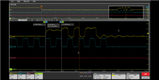

    This is what I see when I read lets suppose 128 bytes using OSPI_readDirect and the probing happens exactly when memcpy is executed.
    Pretty sure its the data bits seen on the waveform as for sending command and address bytes, D0 line sends the bit 0.

  • probing happens exactly when memcpy is executed.
    If so, it is command and address stage, not the data read back from flash stage.
    We need to see the first Data bit edge of read data. not command and address stage data pin waveform.

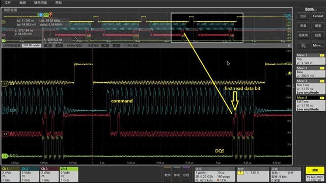

    I have got the DQS and Data line D0 probed and saw the signal as follows:
    I have read 128 bytes.
    You see the behaviour when you are reading how many bytes? Also, I am assuming you have Phy enabled as well, because then only the DQS line will be effective else its not used.
    Vaibhav
  • The waveform is somewhat distorted, I suggest turn off phy mode to slow down the frequency.
    DQS is valid even if phy mode turn off. Your DQS waveform seem some problems, not sure it's a wrong pin or oscilloscope problem

    DQS is only used when we enable Phy, so combining DQS with reading while phy is not enabled, does not makes sense.
    Infact reset value of DQS enable field in one of the OSPI registers starting from FC40000 is 0, and not 1. It is set to 1, when we call the API OSPI_phyTuneDDR or OSPI_phyTuneSDR
    Vaibhav
