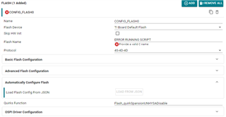

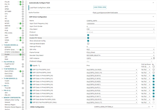

I'm trying to add a QSPI flash device, but there is no option to change the OSPI driver from 8 to 4 data lanes even when I select 4S-4D-4D mode.
I read elsewhere in the forum that I should import the flash configuration .json to resolve this.
However this gives me an error.
Before clicking the "LOAD FROM JSON" button:
After clicking the LOAD FROM JSON button:
The flash name changes to "ERROR RUNNING SCRIPT" but there's no further information given.
I have tried loading both:
mcu_plus_sdk_am243x_10_01_00_32\source\sysconfig\board\.meta\flash\S25HL512T.json
and the attached .json file that I generated using the ospi_flash_diag_am243x-lp_r5fss0-0_nortos_ti-arm-clang project.
Steps to reproduce:
1. Create new sysconfig file and add a Flash device.
2. Press "LOAD FROM JSON" and select one of the referenced .json files.
