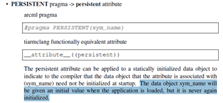

When I use the "persistent  attributeon MSPM0G3507, I see that the variable is allocated in the SRAM and is re-initialized to 0 at RESET or startup:
I want to know if there is any method on the MSPM0G that allows a variable to be not zero-initialized at startup or reset, similar to the persistent attribute works on the MSP430FR.

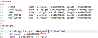

    Below is the method what I used to work with:
    You can add a new memory in cmd file:
    SRAM_NOINIT (RWX) : origin = 0x20200000, length = 0x00000200
    Then, you can add a new section in cmd file:
    .NoInitSection : > SRAM_NON_INIT TYPE=NOINIT
    After that, you can set the variable in this new section:
    __attribute__((section (".NoInitSection"))) int32_t test = 0;
    As for persistent, the detail clarification you can find it in TI CLANG user guide:
    https://software-dl.ti.com/codegen/docs/tiarmclang/compiler_tools_user_guide/
    So it will aslo be initialized once the application is loaded. While it should non-initialized again during the reset.
    I see the compiler warning if I use __attribute__((persistent)):
    Please manually add this sections in cmd file and take another try.

  • Thank you very much!
    I followed your instructions:
    and the variable in SRAM is only not reinitialized upon a level 0 reset  as described in the table:
    DL_SYSCTL_resetDevice(0);
    However, when I perform a hardware reset or other reset levels, the variable still gets reinitialized.
