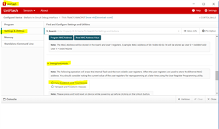

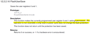

    I don't think you can use dslite to program the user0 register. This is normally done as part of the code using FlashUserSave() API or using tool such as LM Flash Programming or Uniflash. See below. I think dslite only programs your desire value to address 0x400fe1e0. Your data.bin file is not a program that will carry out execution to make user0 permanent. You can refer to the FlashUserSave() API source where it writes to the COMIT bit on the FMC register to make the register permanent. The API will wait in a loop until the operation is complete. This is not a just a simple write to a register. This is programming a non-volatile register which is similar to programming a flash memory address where the programming can take up to a few hundreds of uS.

      I have not used dslite to write USER0 register. You will need to make dslite write to the below three addresses.
      HWREG(FLASH_USERREG0) = ui32User0;  // Write value ui32User0 to USER0 register at 0x400fe1e0
      HWREG(FLASH_FMA) = 0x80000000;  // Write 0x80000000 to the FMA register
      HWREG(FLASH_FMC) = FLASH_FMC_WRKEY | FLASH_FMC_COMT; // Write 0xA4420000 | 0x9 to permanently commit the USER0 programming

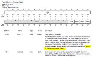

    error: CORTEX_M4_0: File Loader: Verification failed: Values at address 0x400FD008 do not match (expected: 0xA4420009, actual: 0x00000000) Please verify target memory and memory map.
    Failed: File: C:\[...]\fmc.bin: a data verification error occurred, file load failed.

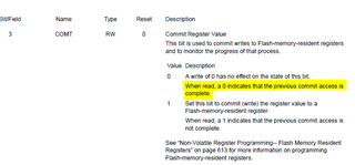

    According to the datasheet, reading the WRKEY will return 0. Reading a 0 on COMT bit indicates the commit is completed.
    You should do a power cycle and check the USER0 register to see if has your written value.

  • ok in fact it was working well!
    i thought 0 was when values where ignored, my mistake.
