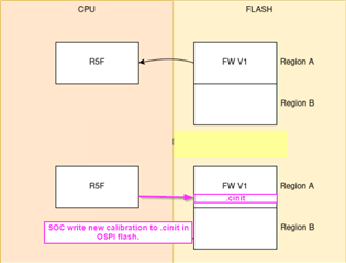

My problem is that I'm using AM263P4 without embedded flash. It loads an .appimage from OSPI flash. A small sub section of that .appimage must be the .cinit table but I don't know how to modify it by the application at run time.
<Question>
Can you give me some guidance on how to identify and modify only the .cinit sections of a multi-core .appimage residing in OSPI flash from the running application please?

  • HI Nilabh,
    Our application runs in RAM. The map file only gives the location of .cinit table in RAM. I need the location of the .cinit table(s) in the OSPI flash in order to change it.
    Visually speaking I need to do this:
    I suppose the question is: How can I calculate the address of .cinit in OSPI flash?
