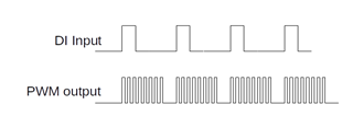

it's possble to trigger PWM with an external signal?
I'd like to have something like this:
Thank you

You mean the DI calling an interrupt handler and coding there the PWM start?
In this case how to stop the PWM?
Can I program it to produce a constant amount of pulses and then stop?
No, but you can set up another timer that is started at the DI interrupt and stops the PWM when it expires.
