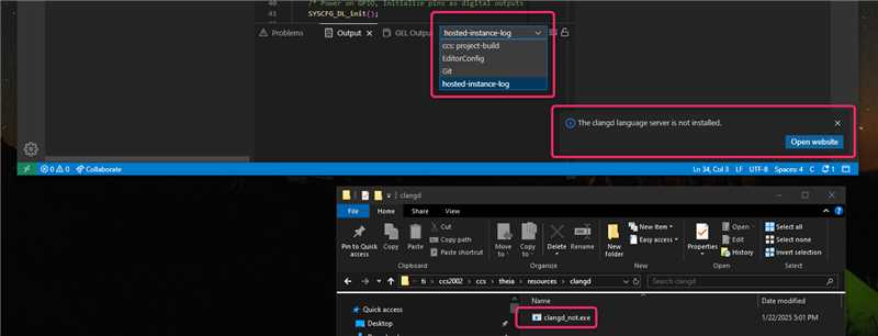

    Can you rename the clangd.exe executable in <CCS INSTALL DIR>\ccs\theia\resources\clangd (effectively disabling it) and see if this helps?
  • disabled clangd as you suggested and so far so good, working much much better.  I have not noticed any change or decrease in functionality.  what does clangd do?  autocomplete?  do I need it?

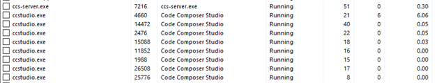

  • problem is back. Killed running clangd no change.  Now see three instances of ccstudio, is this expected?  all running close to 100% CPU.  Reminder I am on a 8 core machine so 12.5% of 8 cores is 100% of one core.
  • I exited CCSTUDIO and you can see there are still 2 x CCSTUDIO processes running.  Help me understand why this is?  I will now manually kill them but seems like I should not have to do that?
  • restarted CCSTUDIO and now see 8 instances of CCSTUDIO running?!  Whats going on here?

    This is odd. When I renamed clangd, I got a message in the bottom right about clangd not being available. Also, the option to see clangd output is gone from the Output view.
    Do you see clangd.exe process running in task manager (I do not see it if the exe is renamed).

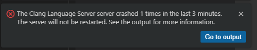

    But turns out that clangd is NOT the problem.  I can kill it, I get a notice in CCSTUDIO that it has crashed and will not be restarted, and CCSTUDIO performance is still terrible.  10+ second delays from time I click on something until there is a response to the click.  Its horrible,  I really need help!  Please respond to my other posts:
    why are the 8 instances of CCSTUDIO running when I have one CCSTUDIO window open?
    Why when I exited CCSTUDIO where there still 2 instances of CCSTUDIO running?
    This is not uncommon and expected depending on what CCS is doing.
    This should not be. If this happens, then it looks like CCS was not shut down cleanly. It was likely in a bad state when the shutdown occurred.

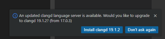

  • update - after reinstalling CCS I now decline the invitation to update clangd and CCS is behaving much better.  Ironically the "dont ask again" does not work.  no matter how many times I click it about a minute later the box pops up again.  Given how apparently damaging upgrading clangd is you really do not want a bug here, ie you really do not want to repeatedly make people decline the very update that is spiking CCS's performance.
  • Thank you for the update. That update request must becoming from the extension you have because we do not prompt to update clangd. We definitely want people using the clangd we ship with.
  • adding to the frustration I kill clangd and get this message
    and despite saying that "the server will not be restarted" you guessed it, the server IS restarted.  I have not installed any extensions that I know of. I DID enabled "check for updates" for clangd so I unchecked that.  See below for extensions that are installed.  I did not install any myself so I assume these are pre-installed?

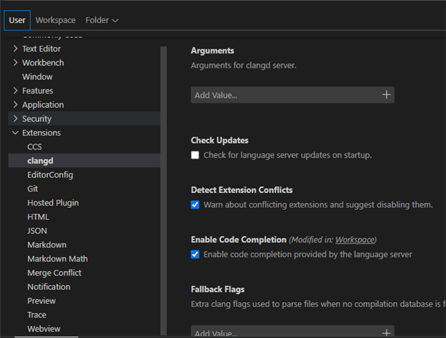

  • I have not installed any extensions that I know of. I DID enabled "check for updates" for clangd so I unchecked that.
    ah ok. That is why you got the message to update from 17.0.3 to 19.1.2.
    Note we have a 20.1.1 planned some time end of the month (or early next month). It includes and new clangd implementation that addresses several (but not all) known issues. Hope it will help with the issues you are experiencing.
