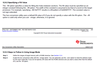

Hi Chris,
See the description in the compiler documents:
It only valid in image mode, while in image mode, you requires the ROMS to enable it.
