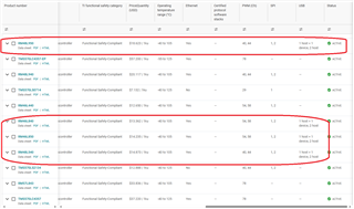

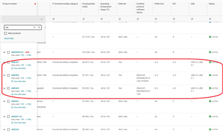

Hi Matteo,
The RM57x doesn't consists of USB:
In Hercules series the USB available on the following controllers,
Some of the RM48x and RM46x controllers.
For more details refer below link:
Arm Cortex-R MCUs product selection | TI.com
Some of our new controllers like AM243x also consists of USB.
Based on your project requirements you can choose the controller.
