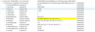

customer has found that the symmetric key for decrypting the data from the ROM bootloader is not provided to the HSM Runtime.

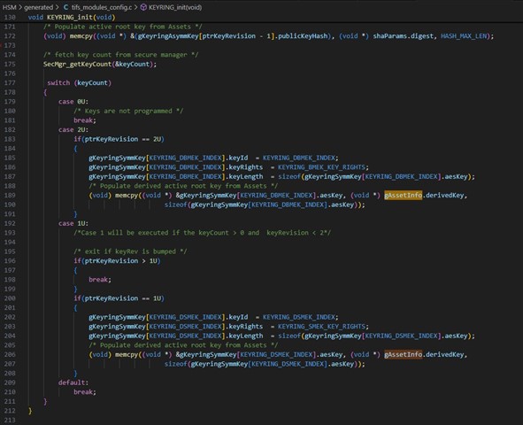

In the generated function KEYRING_Init() in the file TIFs_modules_config.c, the key from the gAssetInfo.derivedKey is copied to the gKeyringSymKey array.

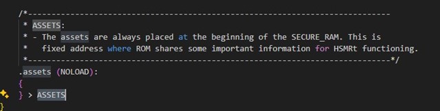

However, the information gAssetInfo.derivedKey is 0. GAssetInfo is described by the ROM loader according to the information from the linker file.
How do they get to the symmetric key? Do they need to access the OTP data directly?

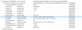

    You would see the gAssetInfo.derivedKey is 0 when the SBL and HSMRt are not encrypted. This parameter is filled by ROM and as SBL and HSMRt are not encrypted, this is filled as 0.
    In the SDK you could make ENC_SBL_ENABLED = yes to encrypt the SBL binary and in TIFS you could make ENC_ENABLED = yes to encrypt the HSM binary.
    After this, you should this derived key populated.
    No Encryption on SBL and TIFS images
    Encrypted SBL and TIFS images
    Hope this answers your query
    Nikhil

  • The ROM would write the keys to the asset info, only when we provide the salt and iter count. If not provided, then the symmetric key would be in the raw form (i.e. not derived) and putting the same into the asset info is a risk to the security.
    So, salt and iter count is a must for this.
    Even the keyring uses this derived key to decrypt the keys passed via keyring.
    So without salt and iter count, the derived key is not written and the decryption by TIFS cannot happen

    If customer is not using auxiliary keys (i.e. keys imported via keyring) to encrypt the application, then they would have to encrypt the application with the same derived keys (i.e. same SMEK / BMEK + salt) used to encrypt SBL image.
    This is because, ROM populates the gAssetInfo.derivedKeys upon decrypting the SBL and the TIFS uses this gAssetInfo.derivedKeys to decrypt the encrypted application.
